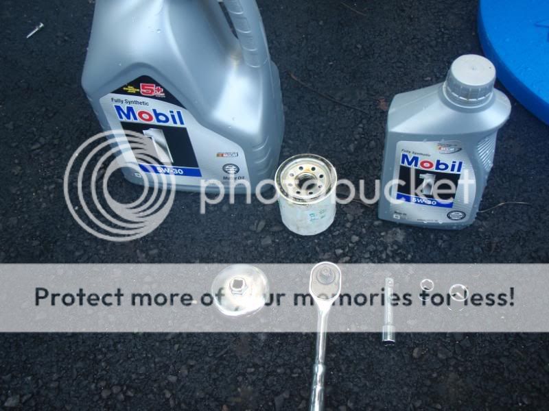

Changing Engine Oil.....
For those of you DIY......run the mada for 10-15mins or normal temp.......This is what u need
Oil filter wrench, 10mm, 14mm, Oil pan not in the pics..
jack up or ramp whatever u prefer..
steel plate cover ...take 4 bolt each corner use 10mm and loosen the bolt to gain access oil filter.
before you loosen the drain plug make sure you take the oil filler cap off first.
then use 14mm for the drain plug loosen it with your finger once loose
let it drain........then fill it with new oil...........enjoy......any comment welcome
