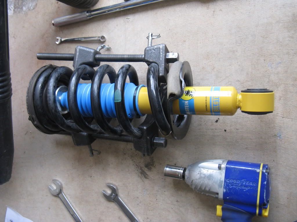

Next it's time to transfer the spring to the new strut
A vise would be nice for this...but I did it without one
Put the rented spring compressors in place and slowly and evenly compress the spring. Once the spring is loose and the top spring plate can move freely it's time to remove the top nut on the strut piston shaft. I used an 8mm socket on the strut piston shaft and wrench on the nut (don't remember what size off hand) and be careful! As Drivers side sheared...and that was not fun!

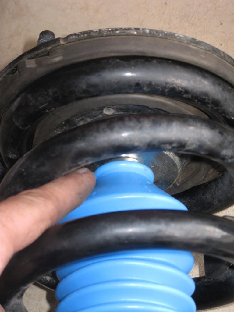

Remember to place the big washer that came with the Bilstein HD's on before anything else gets put on the strut! (FOLLOW THE DIRECTIONS THAT WERE IN THE BOX!)
Then put on the spring and spring plate (my upper spring plate isolators where still in very good shape but you may want to replace them if they are torn or if you just want too). REMEMBER to place the spring in the same place (with the end of it outward as in the picture!
Then put the new nut (from the Bilstein HD's kit) on and tighten according to the specs on the Instructions that were included...I believe its 40ft lbs.

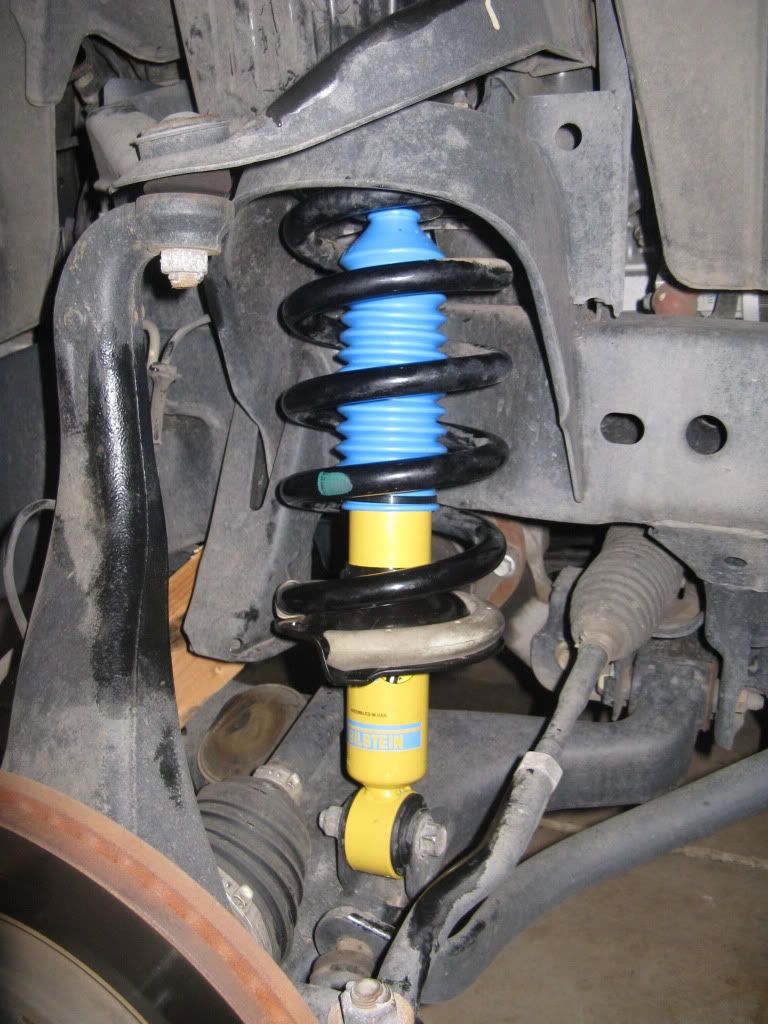

Then it's time to replace into the SUV.....using your big 2x4 and a helper get it back into place.
Tighten the 3 nuts on top and the big bolt and nut (don't recall the specs off hand...but I did them good and tight) Double check your work on both sides!
