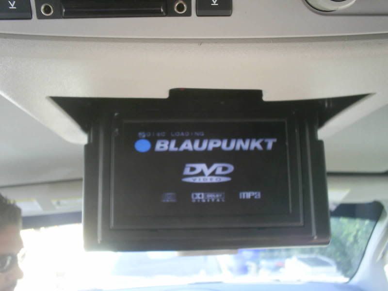

Here are some pics of the finished product... I did not take any pics along the way because I was under a rather tight schedule and working alone.
The first pic is of the overhead. As I said, I used fiberglass and bondo to mold the monitors bezel into the factory pocket. I just didnt like the small gap around the outside or the angle at which the monitor had to be mounted if not doing this. With this done, the monitor is mounted flush with the pocket and angled perfectly to the rear. After I was done, I used a flat black textured paint to paint the monitor surround, the bezel and the inside of the pocket. From the outside it is factory, once opened everything is flat black and matching.

Enjoy, I can answer any questions... AND for those who felt they had to run the monitor wires to the front of the cabin or to under a seat... YOUR WRONG. There are wires inside the overhead that can be tapped to give acc. power.
PS: the rear controls work, and so do the wireless headphones!!!
