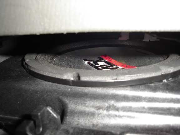

I have two v 12s mounted like the top photo in the floor cargo tray.
The stealth box will fit because the 06 has the power lift gate motor on the right side, not the left side like the 04 and 05's. If you use a big amp amd one of the low depth, low air volume subs, you can fit a twelve into the stealth box. Just give it lots of power and reinforce it with fiberglass or dynomat from the inside.
I have done this in a friend 06, LE.

jameeler said:
The stealth box will fit because the 06 has the power lift gate motor on the right side, not the left side like the 04 and 05's. If you use a big amp amd one of the low depth, low air volume subs, you can fit a twelve into the stealth box. Just give it lots of power and reinforce it with fiberglass or dynomat from the inside.I have done this in a friend 06, LE.
