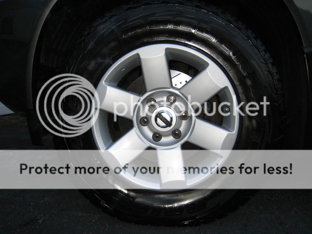

Although I'm no metallurgist, the rotors appear to be regular cast iron with a zinc coating and black painted hat:
I washed them with soap and water to remove the protective shipping oil and there was minimal rusting when dry as I have experienced with uncoated rotors.

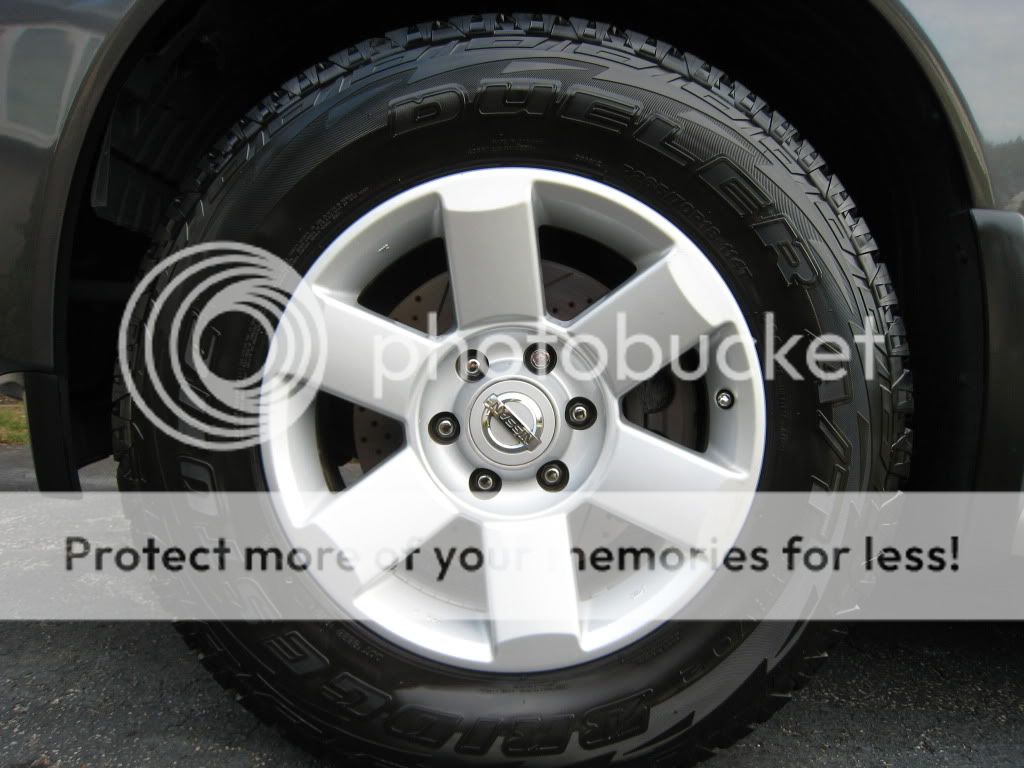

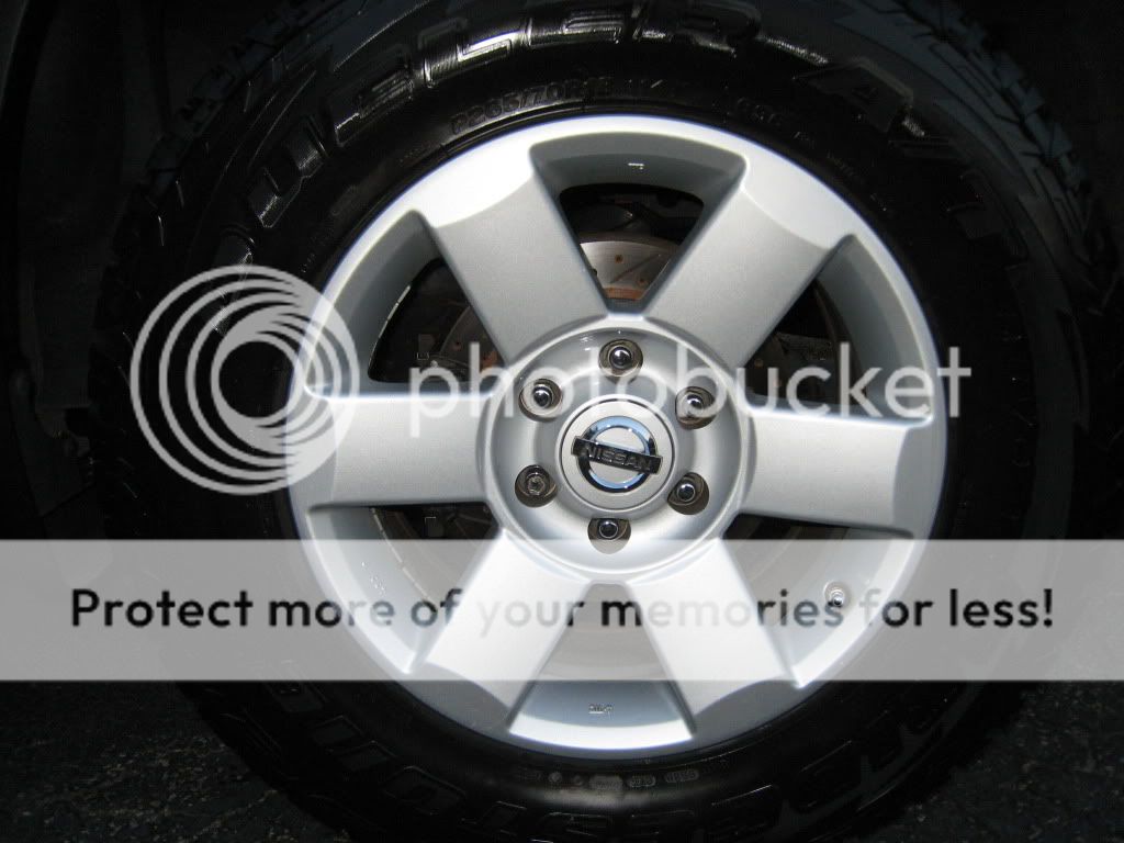

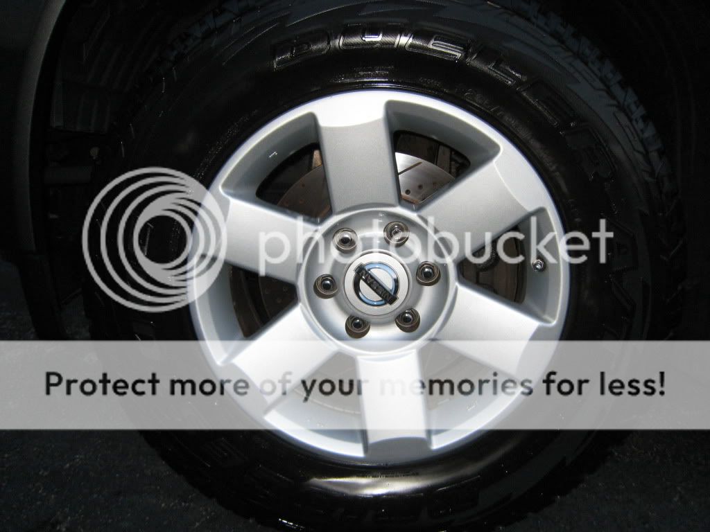

Here is what they look like on the truck (I really have to clean / paint my calipers!). Note that the rust on the slots / holes is normal (same on my M3 with the stock rotors) and will eventually turn black due to dust):
Front:
Rear:
